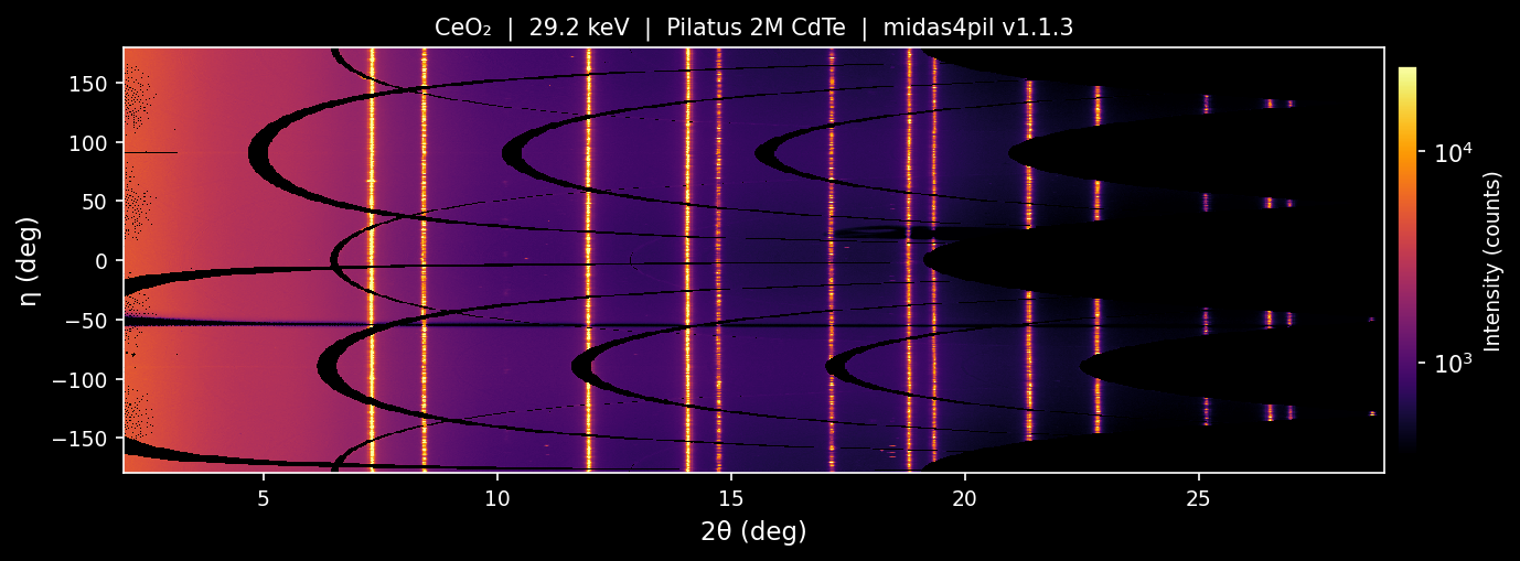

Photo of data visualization in MIDAS4PIL
Image from MIDAS4PIL software
midas4pil is a Python package for synchrotron powder and high-pressure X-ray diffraction data reduction, designed for pixelated area detectors such as Pilatus and Eiger. It implements a complete detector geometry correction pipeline — sample-to-detector distance, beam center, detector tilts, per-panel module misalignment, and radial distortion — following the MIDAS reference model. The central innovation is pixel-matched variable-bin (varbin) integration: each 2θ bin is set to the angular footprint of exactly one detector pixel, delivering the true instrumental resolution without artificial oversampling or interpolation. Calibration against a NIST standard (CeO₂, 29.2 keV, ~350 mm)  achieves a mean residual strain of 117 ppm with per-panel correction. Frame reduction runs at 79 Hz for a Pilatus 2M (1679 × 1475) using precomputed bin maps and numba JIT kernels. A PySide6 GUI provides a full calibration and batch integration workflow. The package is self-contained: no dependency on MIDAS, pyFAI, or Dioptas is required. The detailed technical descriptions, development progresses, and user guide can be found from the following links.
